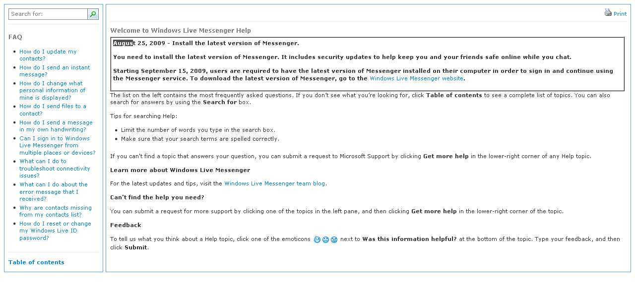

Hb_Kai Posted October 8, 2009 Report Share Posted October 8, 2009 Apparently you're needing to update your Windows Live client.There was an update about three days ago if you don't already have that one.Here's the web page:I also took a look on that link: "What can I do about the error message I received" and it doesn't have any error information on the error code you are getting and 10 or so of those links on there are all titled as "Error Code xxxxx : Unable to sign in". Quote Link to comment Share on other sites More sharing options...
ɹÉuÉllıŹĀ ŹÉb Posted October 9, 2009 Report Share Posted October 9, 2009 Here's the web page:Here is the download page (version 2009, build 14.0.8089.726)http://windowslive.com/Desktop/Messenger Quote Link to comment Share on other sites More sharing options...
